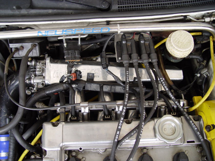

although TT Jake came to my house a few months back with a simular issue. Not sure if 1G's have this or not but on the 2G the sensor that is to the left of the coilpack in this picture went out twice on him and was causing the same symptoms. (the one that is infront of the "NEUSPEED" stickers) - it normally bolted on the intake of a 2G.

I'm not sure how to explain the misfire. It's just missing, sounds like a ignition miss to me. I haven't re-wired anything since swapping the coil pack and ignition transitor out for one from a 92. The car just fine after doing that.
That is the ignition transistor, I'm going to be swapping that too as soon as I can find another one to try.
