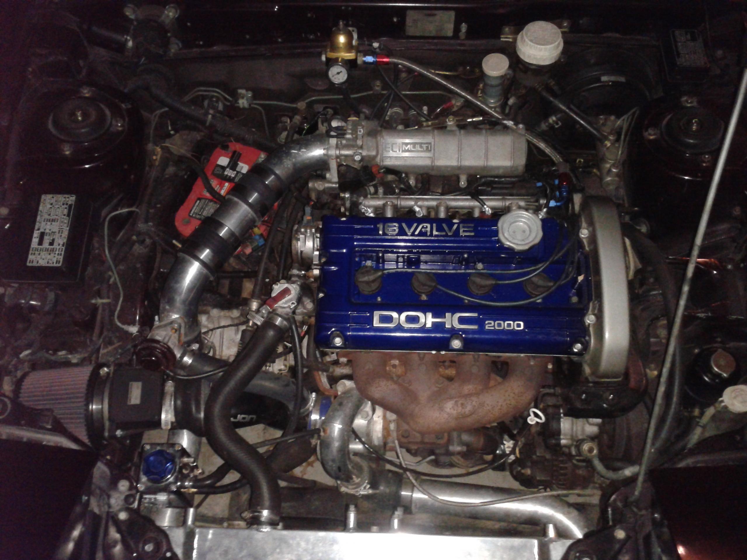

Got her home and started my own tests. compression was 150 across the board, spark was good, along with all 4 injectors being good. but cylinder 3 just wouldnt fire. spark plug came out wet and the cylinder was wet. after sitting for a few days stumped as to why a cylinder with compression, spark, and fuel wouldnt fire it dawned on me to pull the ecu. low and behold, ecu damage!
Grabbed a socketed eprom ecu from 93gtpeater that day and had her running on all 4 later that night, WOOT! The fuel injector seals are still junk and causing boost issues but that will be fixed shortly. seals are already on the way.

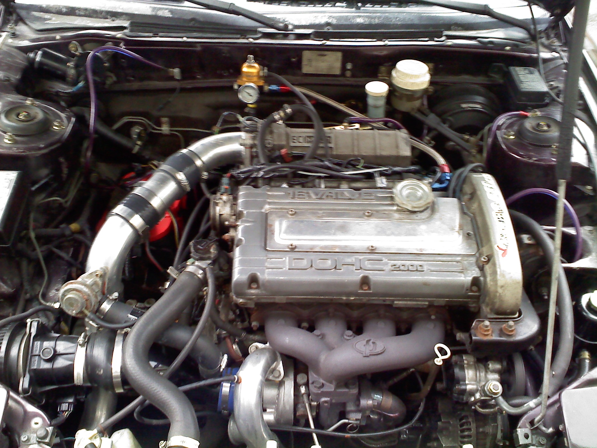

These are from before i let the car go.

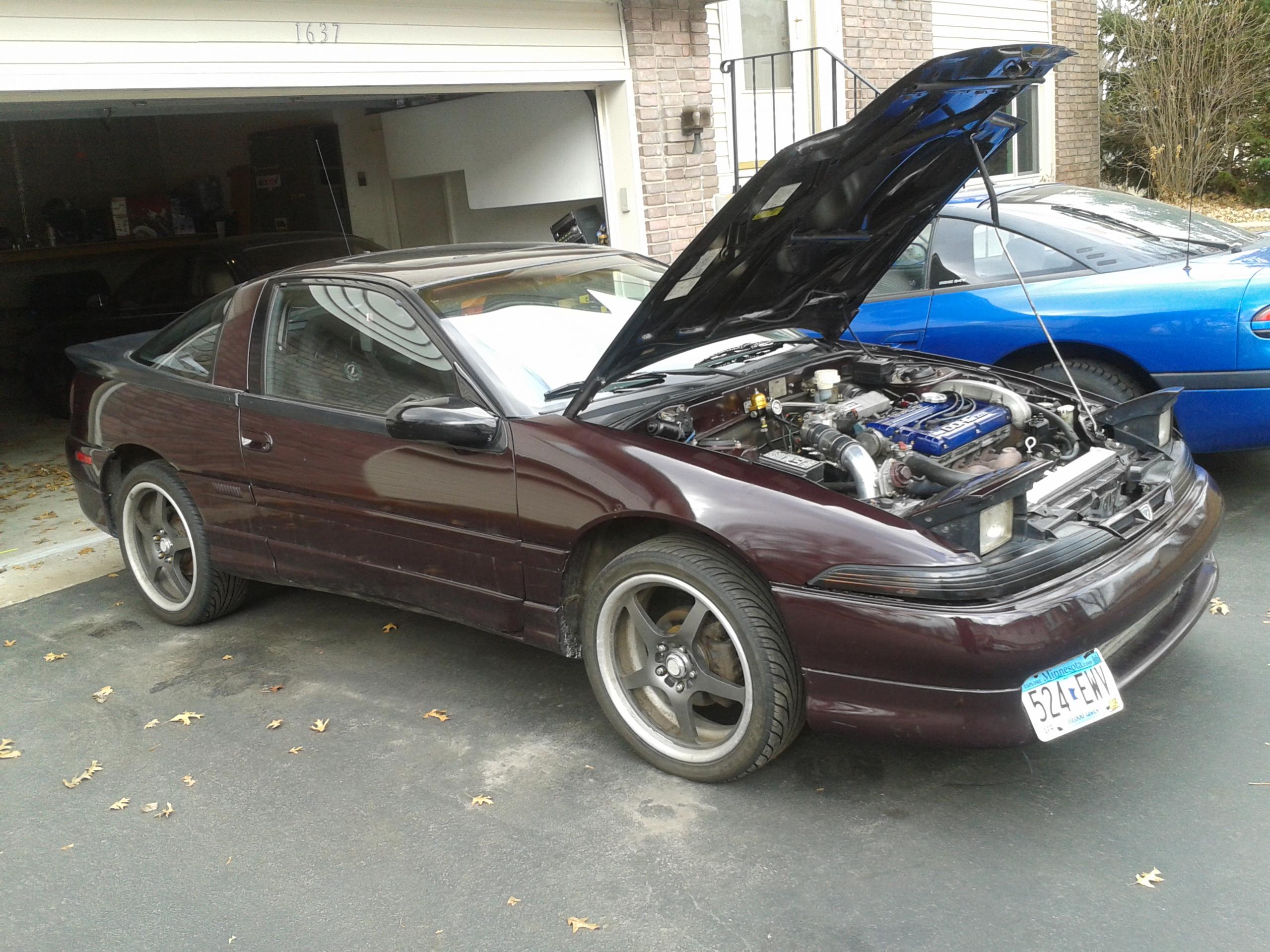

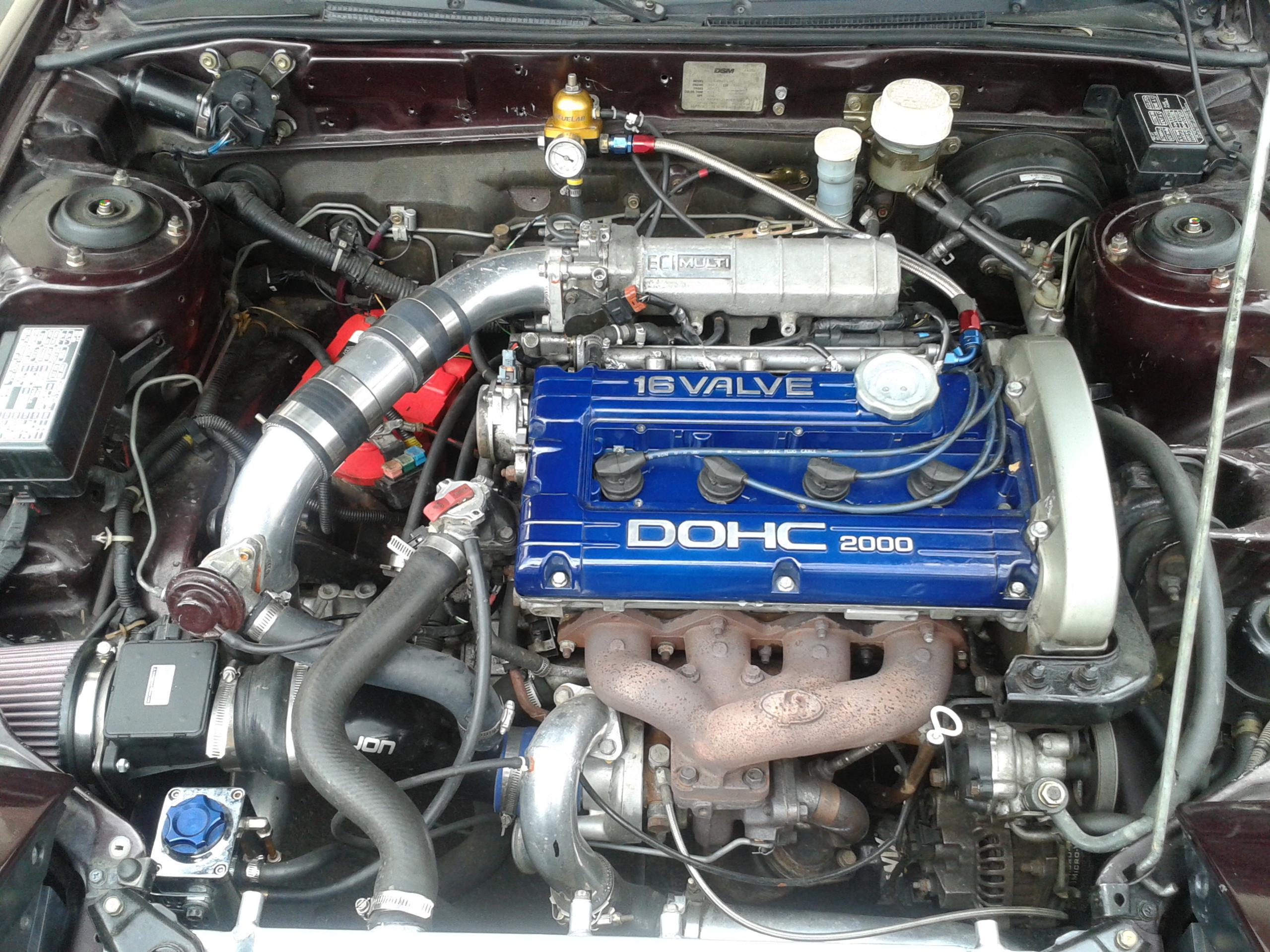

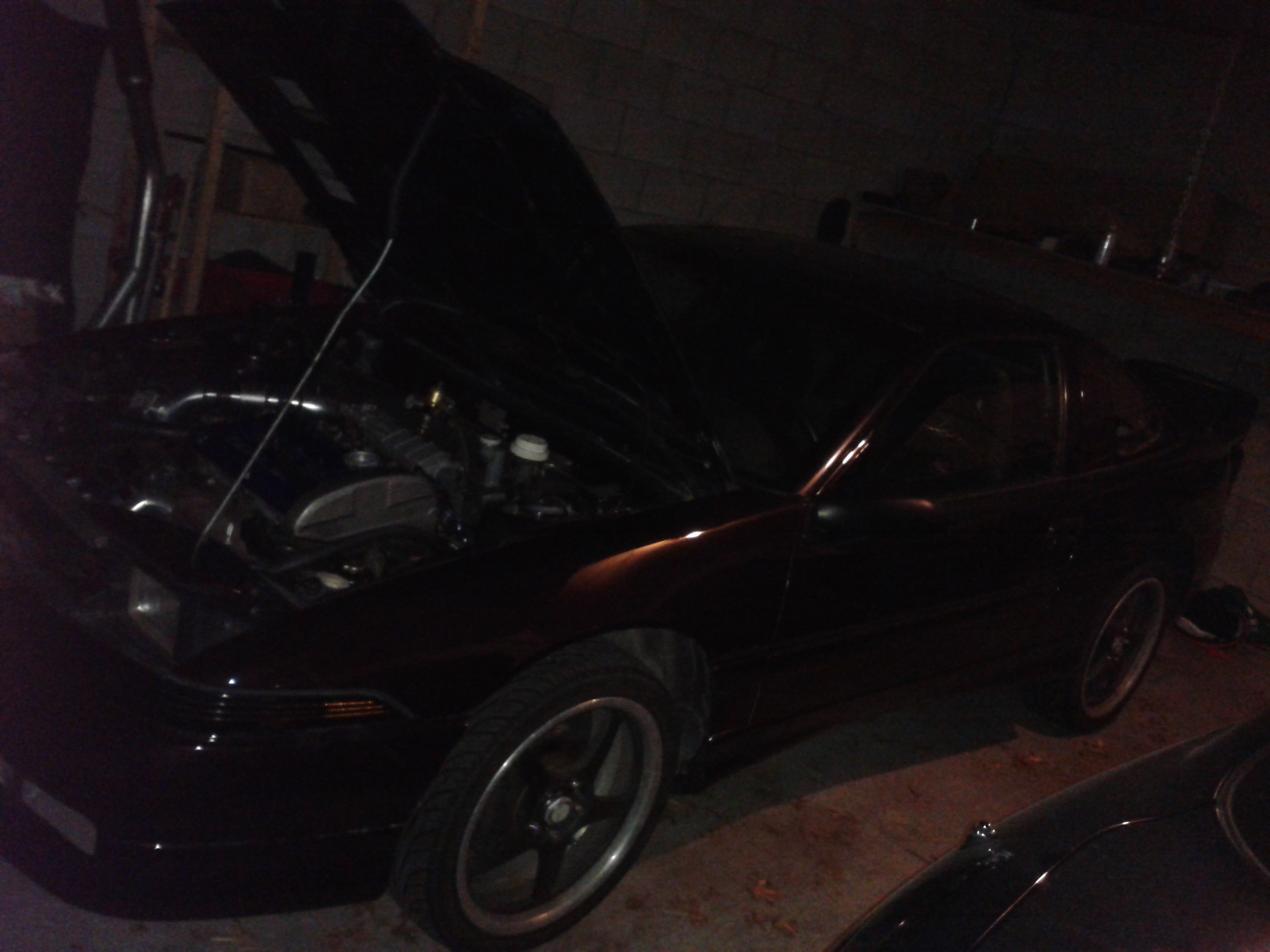

Here are some more i took just tonight. obviously after buying the car back
also i did the wire tuck around the fuel rail the day before selling the car.
Gotta say, even with all the problems these damn cars have. i sure did miss it.
Will also be grabbing some more tomorrow when the light is better. there isnt shit for lighting in my garage.

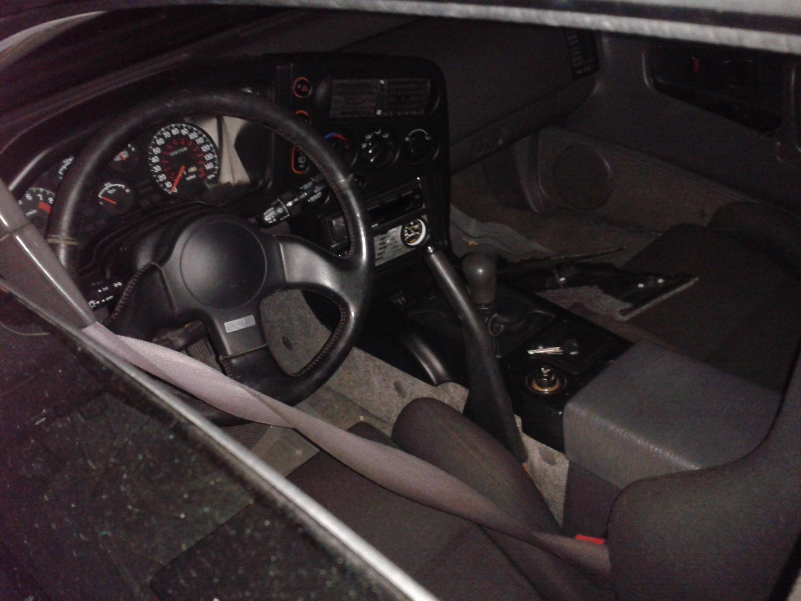

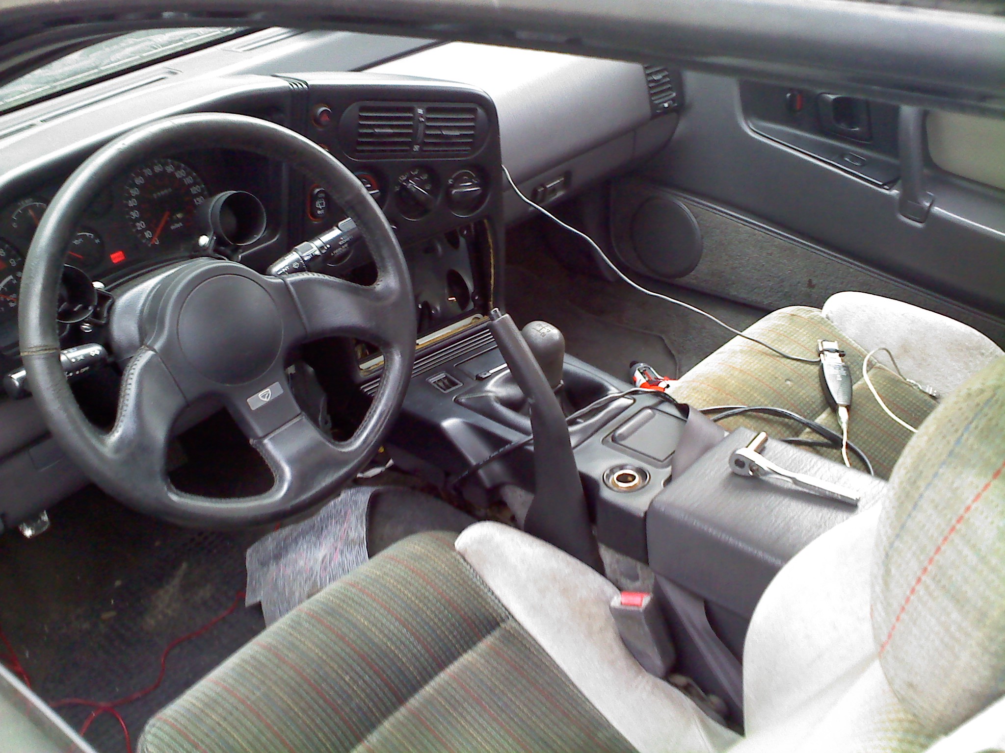

just grabbed these. she needs to be cleaned for sure.

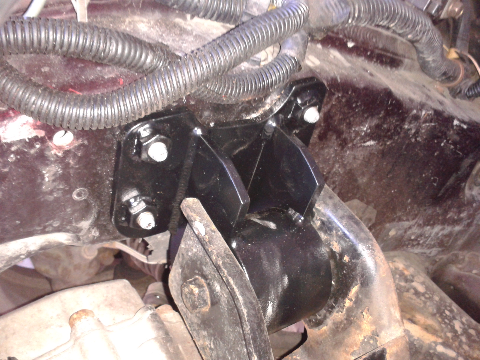

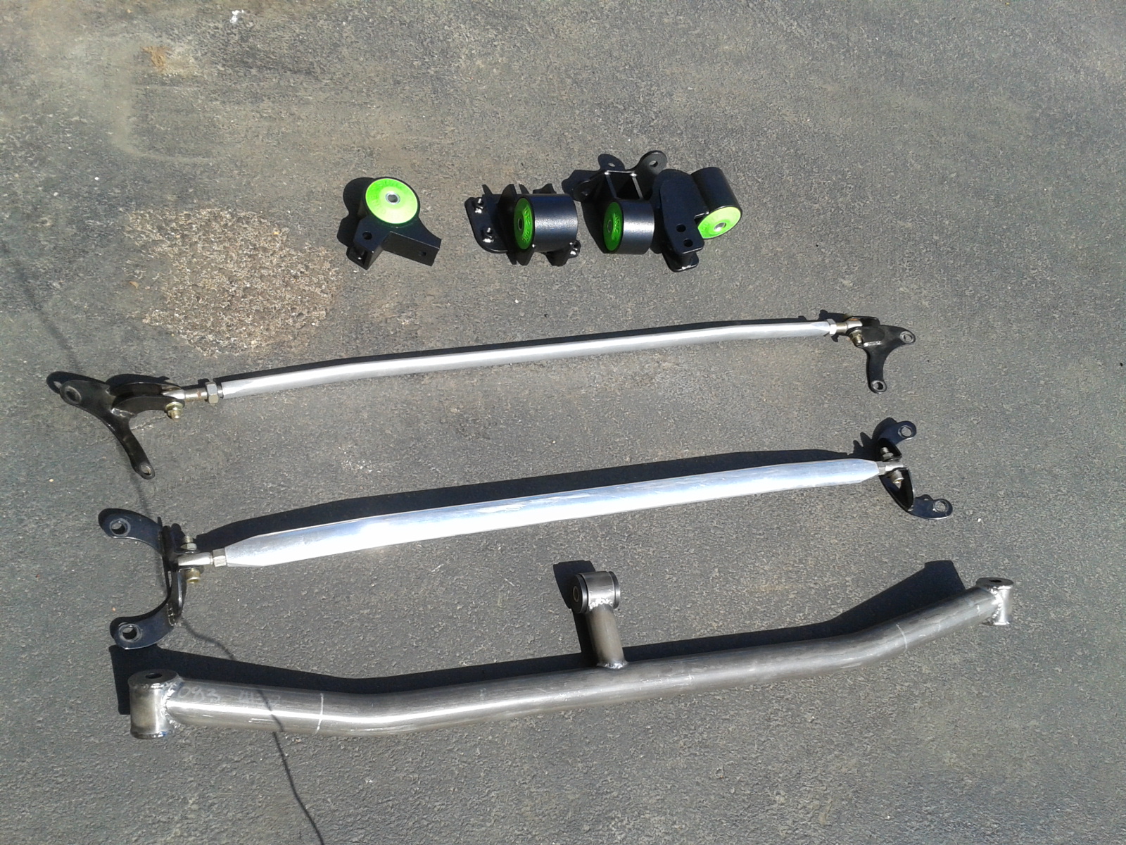

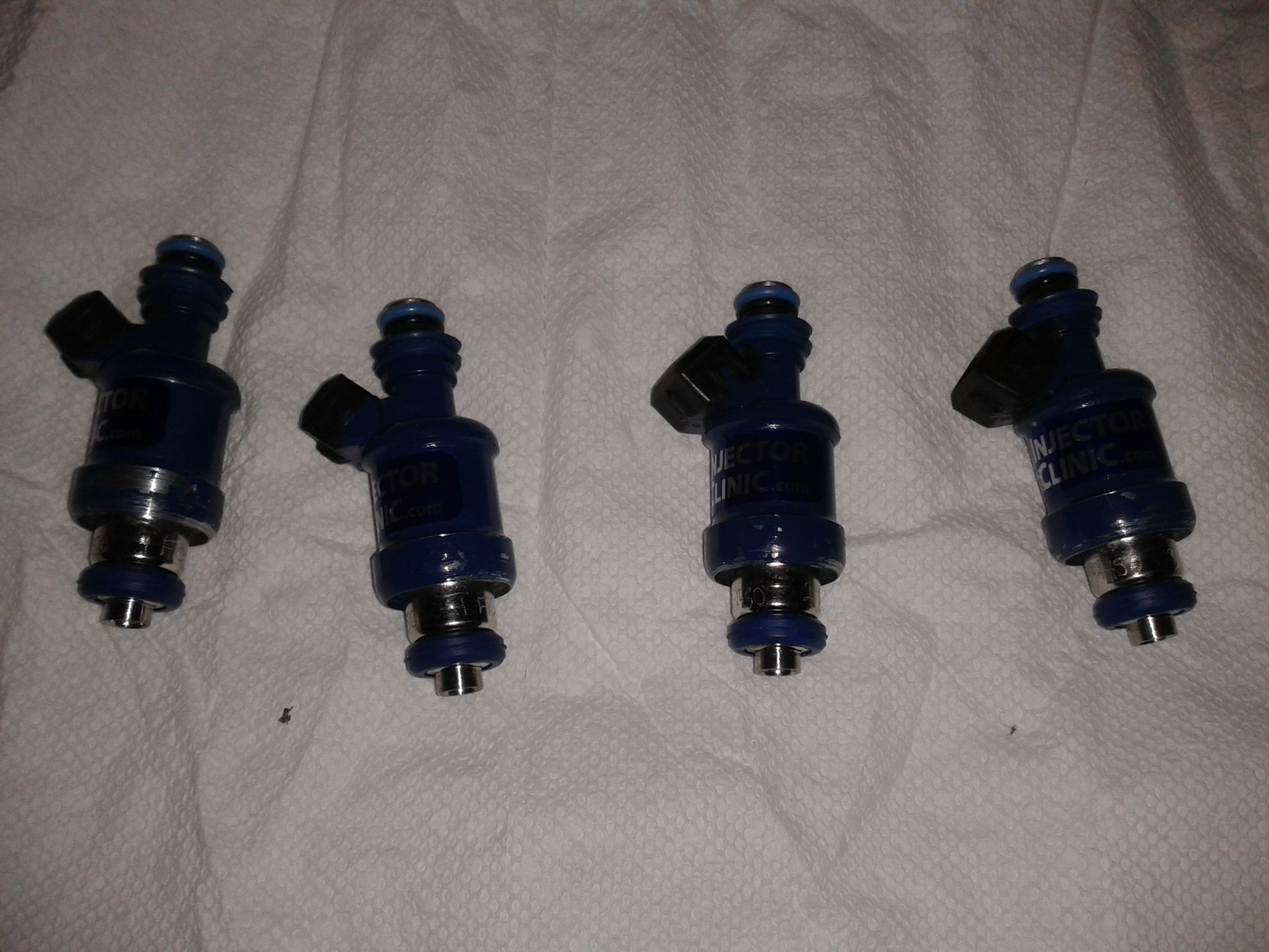

well ive been collecting goodies over the past couple weeks
front and rear strut bars. drop engineering motor mounts. tubular from crossmember with poly bushing, and fic bluemax 1450's

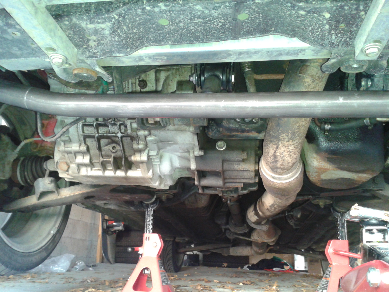

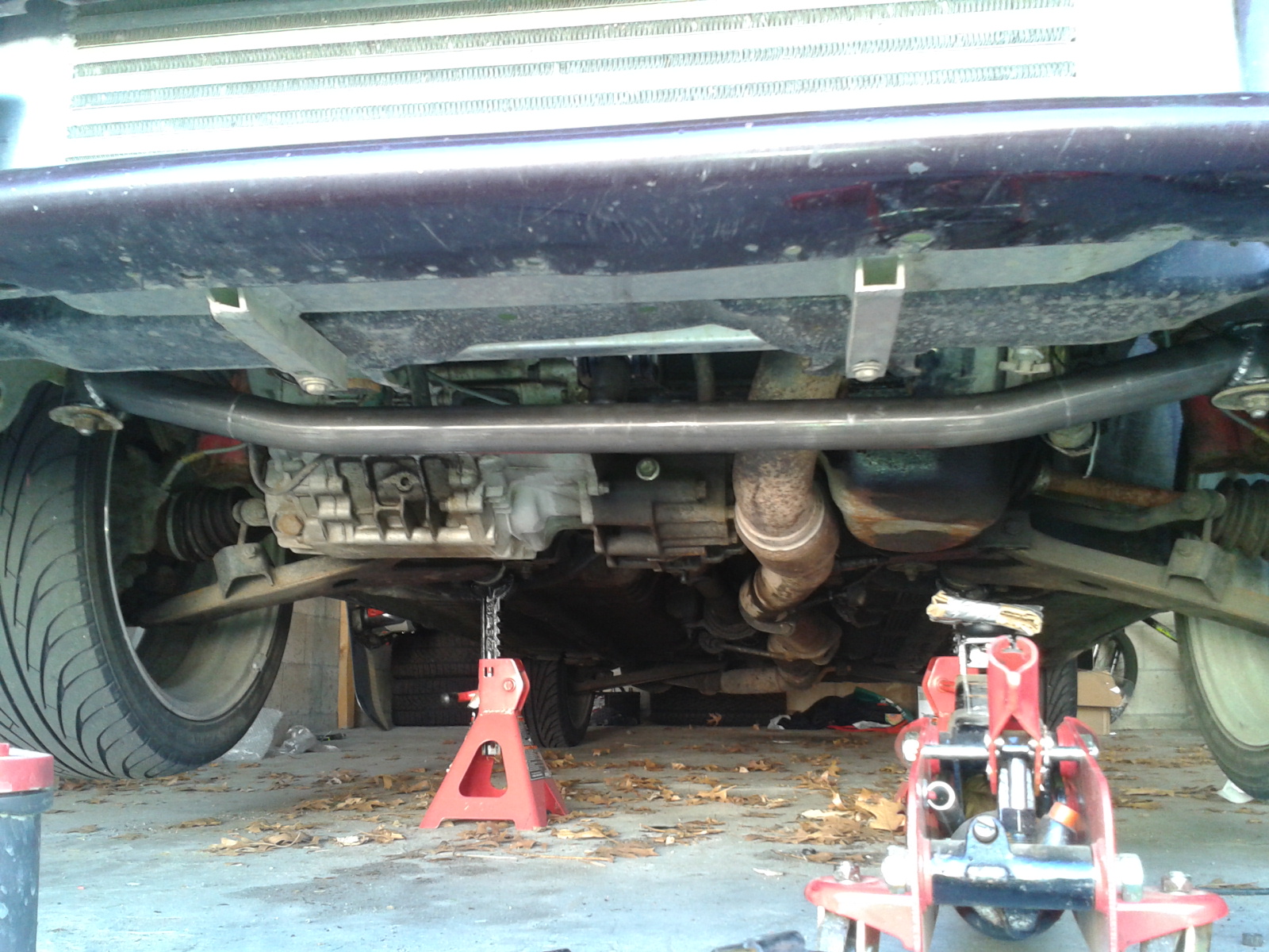

the fuel injectors went in a few days ago and motor mounts and crossmember in today. couldnt break the bolts on the rear mount with the engine in the car, got those soaking in pb right now though.
gotta say with the front crossmember from bulfab. it is a great piece. i got the single piece bar. and it cleans up a shit ton of slop vs just running the stock front crossmember. the stock crossmember alot causes the engine to pivot back and forth because of the rubber mounting bushings. the tubular front crossmember has solid mounts to the car and does not pivot as the stock piece did. very stable and offers A LOT more room to get to things from under the car.

Those drop mounts are pretty good. Drop sent a set when they first came out. I didn't get to drive with them much, but they're darn nice looking. I almost wished the bushings were a little softer though, as with cams, it did have some vibration at idle. Much better than solids though lol. It's nice to see more than a few people doing the tubular front cross members, they look pretty nice.
Old 04-03-2012   #20
viridionplague
Posts: 788
Re: The car i bought twice.
yea they are pretty nice. i think the avid mounts are a little nicer looking but they are 25% more money. the avids do however have selectable "stiffness"
