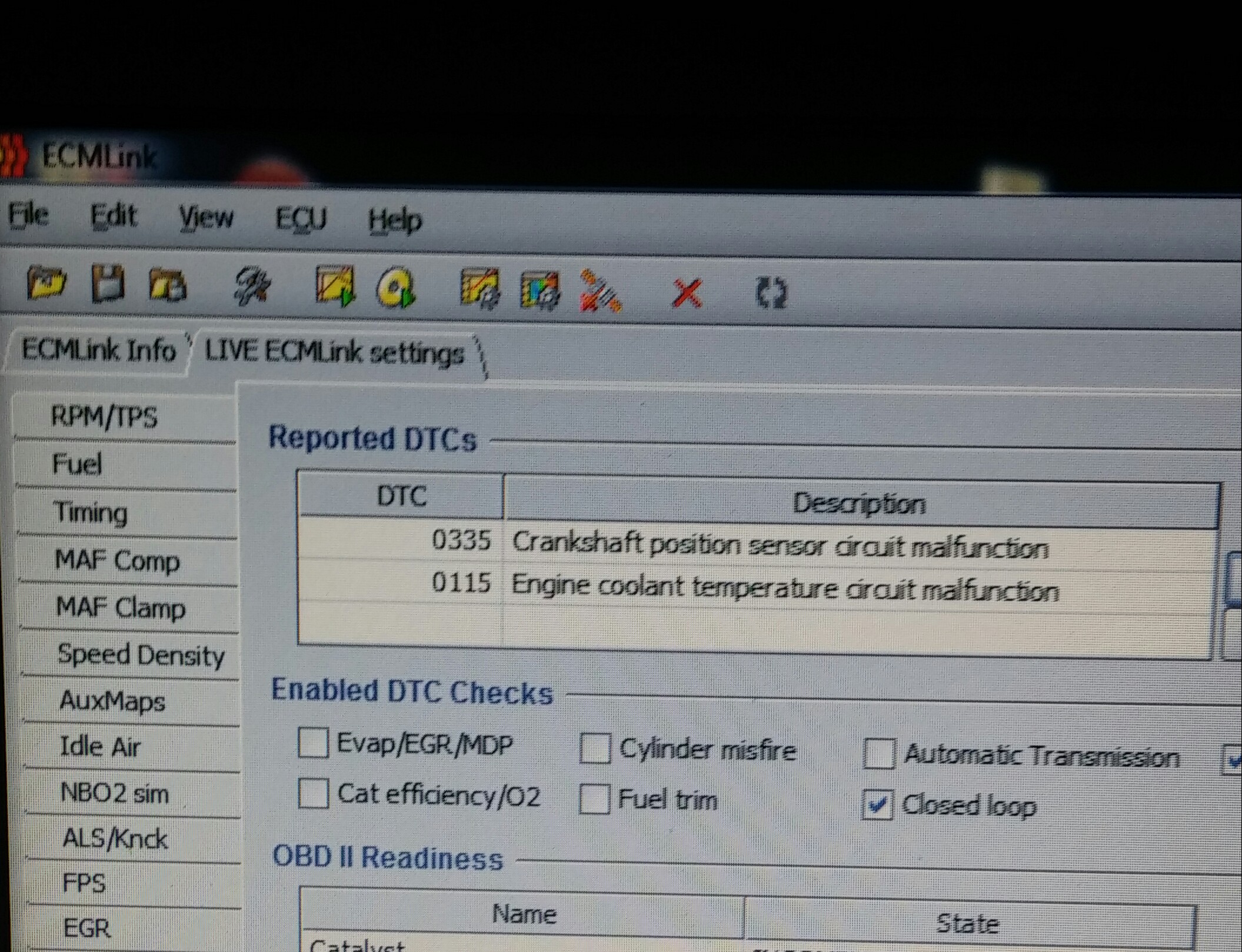

Re: NON Start issue
This is what link says

Re: NON Start issue
Crankwalk

Re: NON Start issue
Have you checked fuses? Is yours still 7 bolt? Checked that all the sensors are plugged in/clean?
I believe I have some extra crank and cam sensors lying around, i'll try to dig them up.

Re: NON Start issue
A bad coolant temp sensor will also cause a no start.

Coolant temp shouldn't matter much, it would just run really rich on startup. Check your crankshaft end play, hopefully it's just the sensor.

Re: NON Start issue
I was thinking the same thing when I read it stalled when he pushed the clutch in. hopefully it hasn't gone walking and the sensor is just bad or the plug came loose. good luck.

Re: NON Start issue
Well i think it walked it keeps poopin up that the cps is bad and i got the new sensor in. So i dont know what to do if someone maybe wants to come check it out before i tear it apart and give input thatll be cool but otherwise im done with it.

Re: NON Start issue
Endplay check http://www.angelfire.com/pa4/awdcrankwalk/
Crankshaft endplay 0.0020 - 0.0071 per AllData for 96 AWD Turbo
Could be wiring issues also, so checking for crankwalk without tearing things apart might save you some time.

Re: NON Start issue
So im like 100% positive it walked so now to decide to part out and get an evo or just rebuild it
