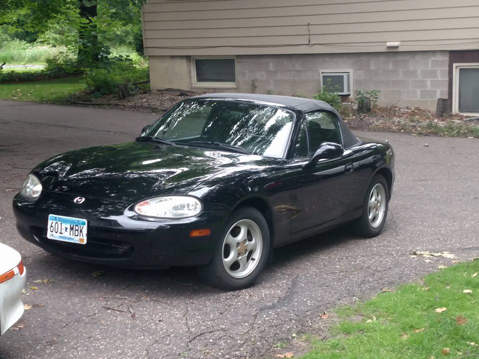

Until I got a craigslist alert:

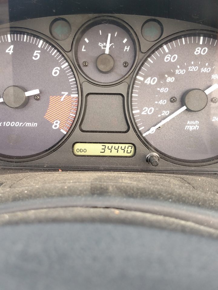

Original owner, 34,440 miles on it. Rochester area, MN.
The vehicle is a PEP package, Popular Equipment Package. Not the "sport" model, but it has some creature comforts as I also want a street car, such as:
Power windows, power locks, power mirrors, no ABS, Power radio antenna, torsen rear differential, a/c.
Eventually I'll make it a bruiser of a HPDE vehicle that is still street driven. That's the fun part about a Miata, I don't have to strip it to hell to have fun and get "90%" of the way there. I intend for this car to be 80-90% badass at being a street car, road course car, auto-x, and look good.

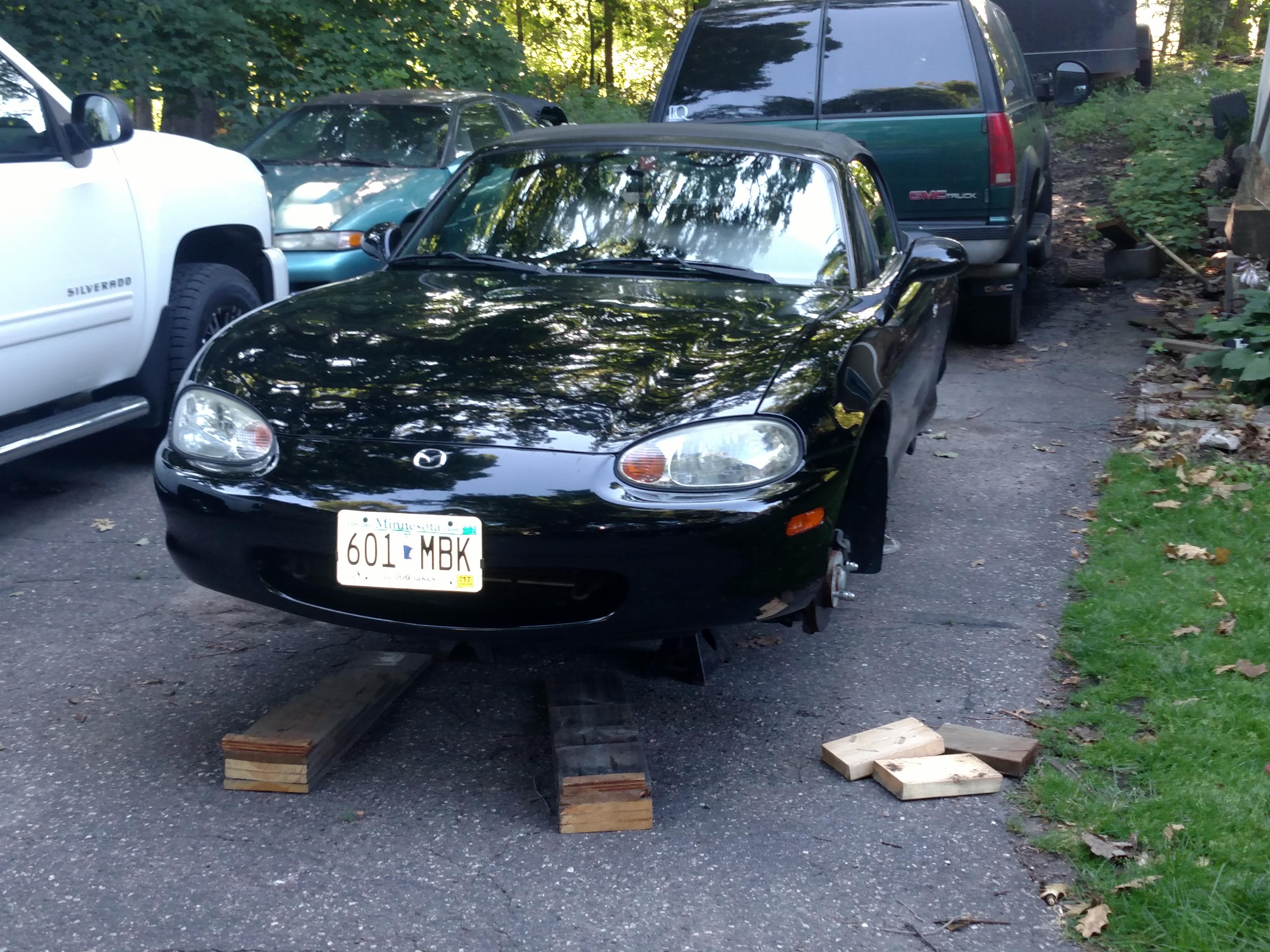

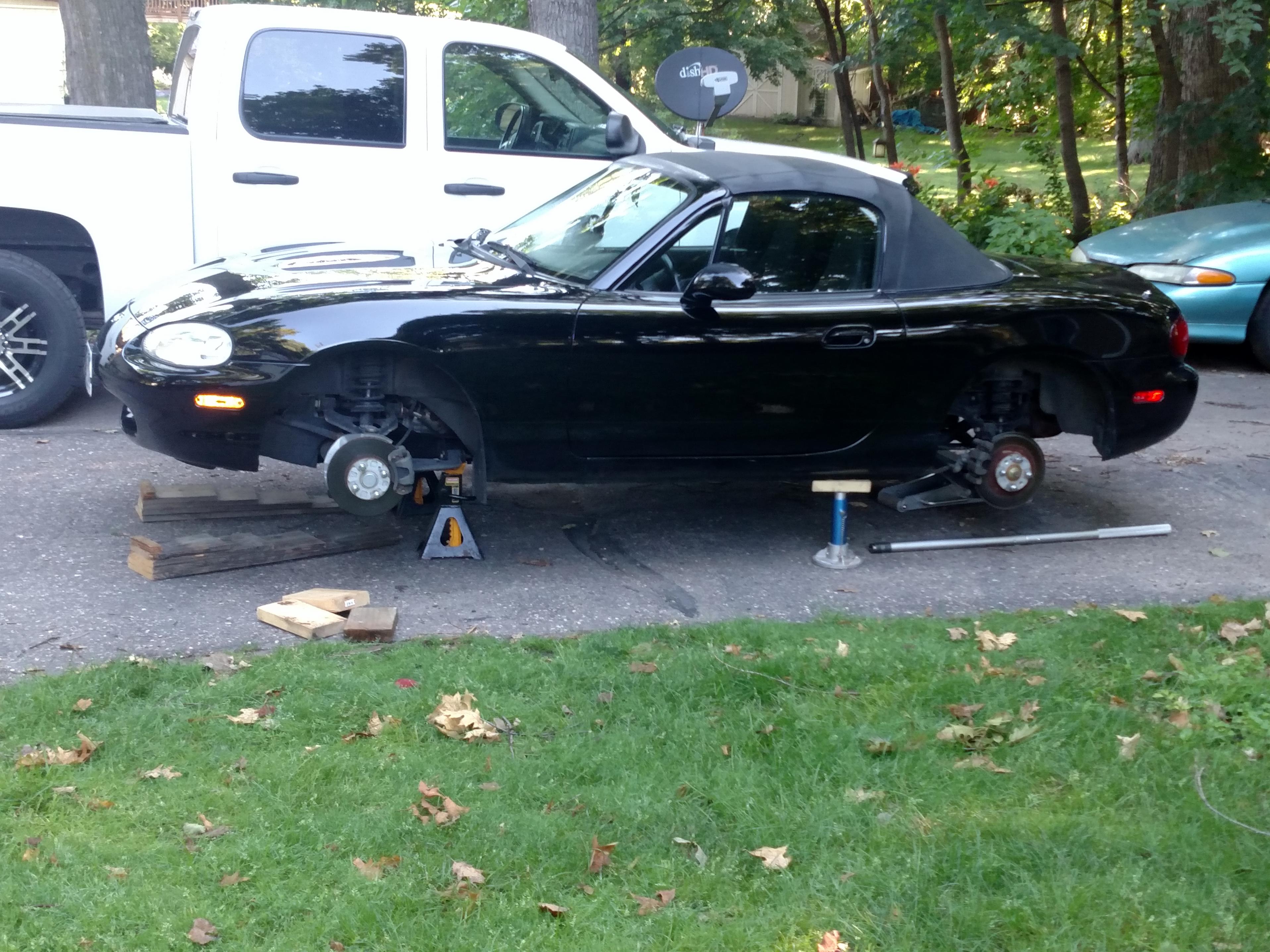

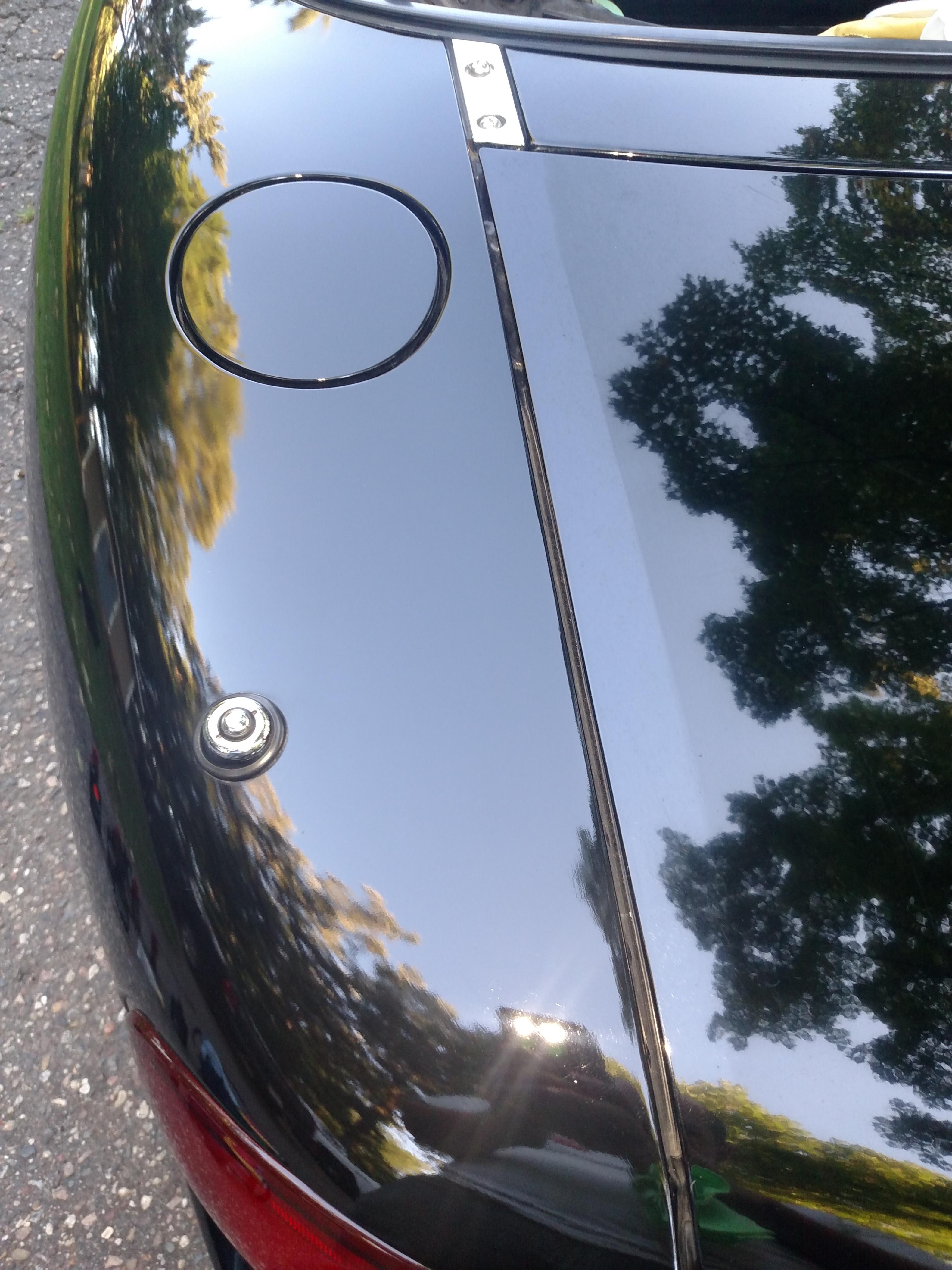

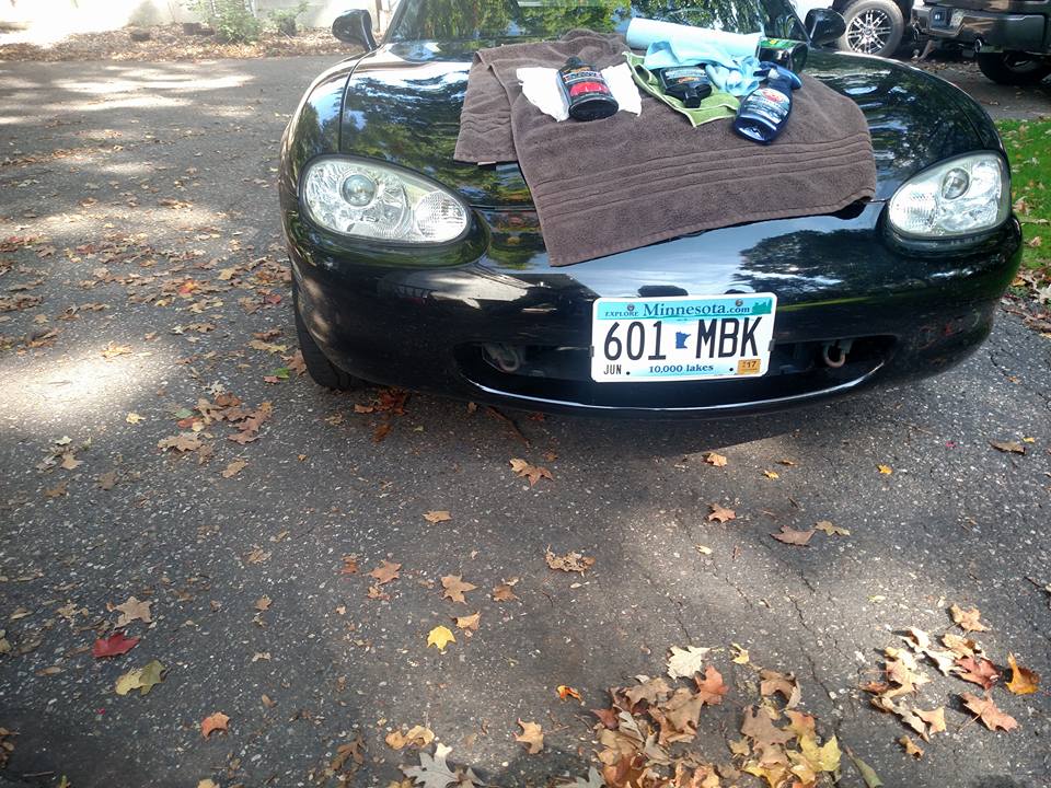

Did some quick paint restoration check, I'll need to do a high speed buffer to get the paint 100%.

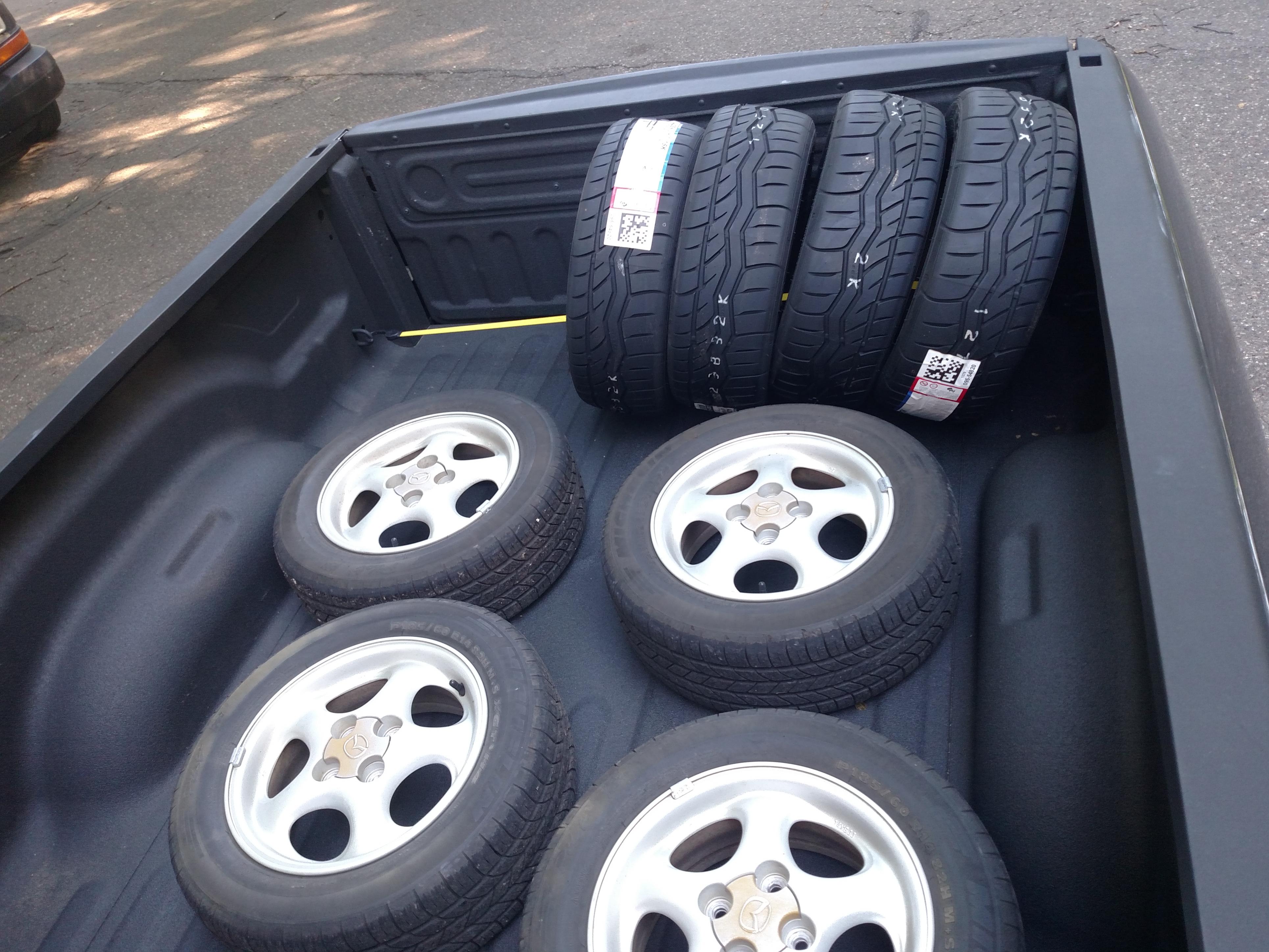

Tires went on Saturday.

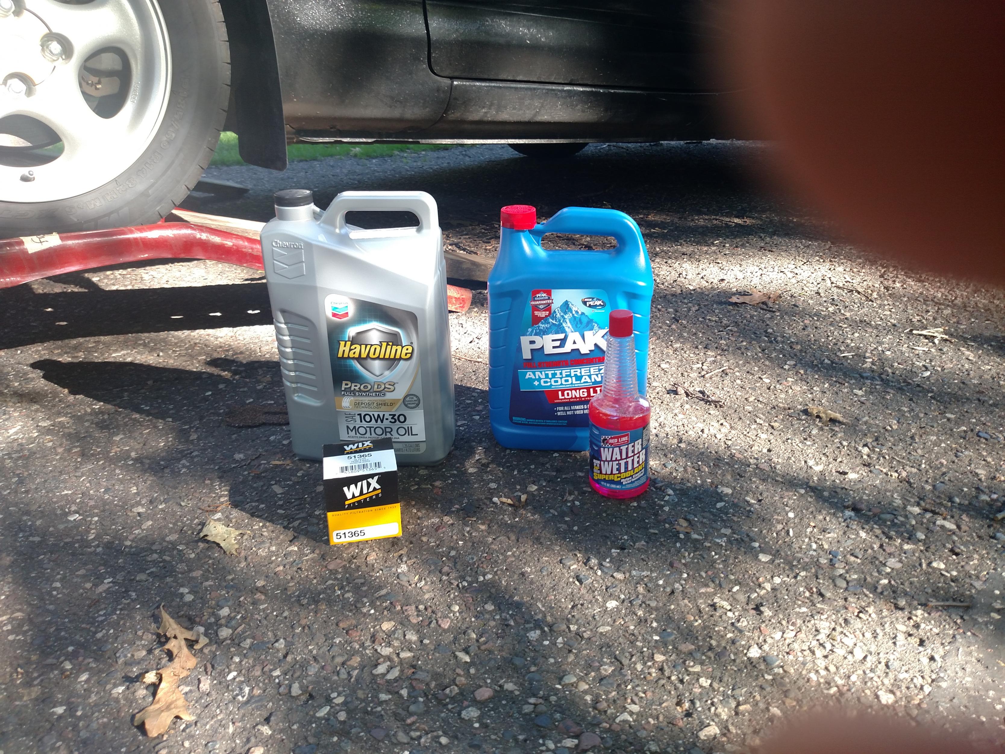

Brake fluid and clutch fluid swapped to Dot 4, synthetic oil change complete, coolant swapped and redline water wetter added.
This week:
Trans/Turret fluid, spark plugs, rear diff fluid, performance alignment. First autocross day on Sunday!

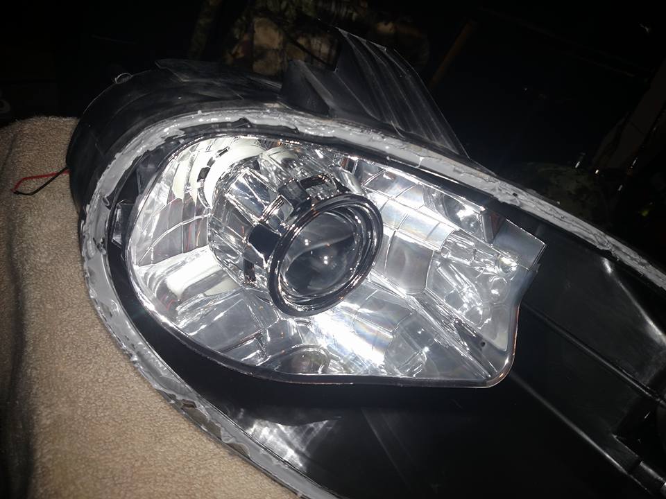

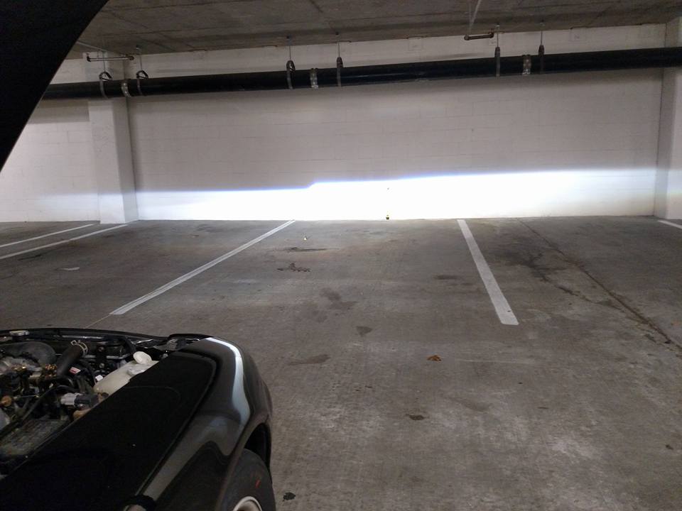

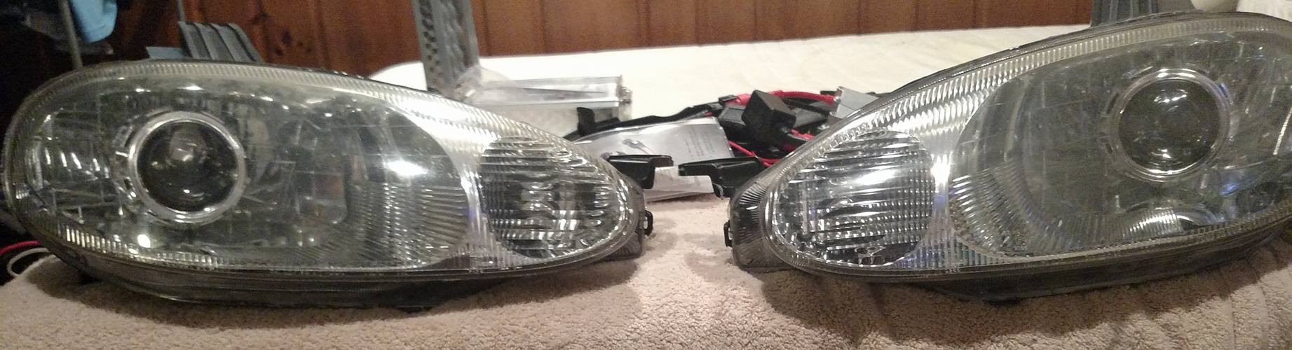

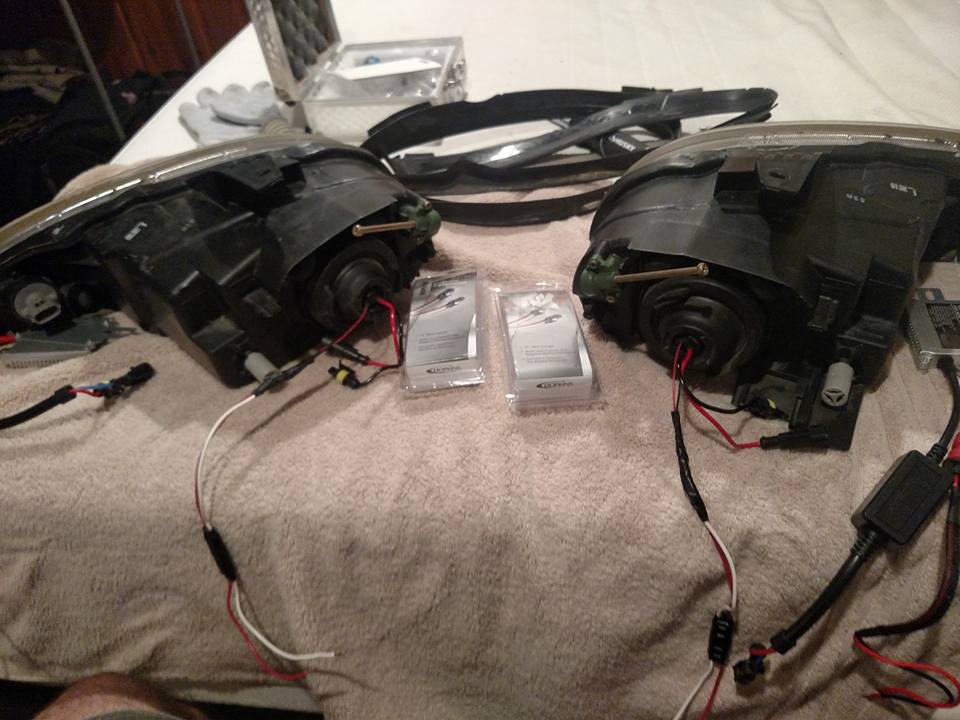

The factory headlights suck, so I added HID's.

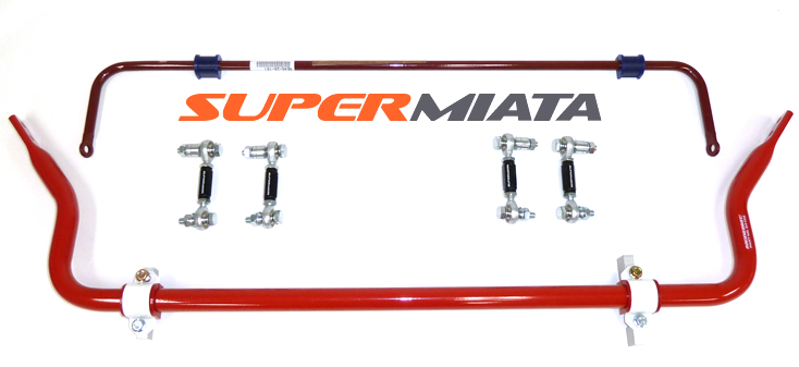

Now to hurry up and wait for the next performance upgrade:
Front Racing Beat sway bar, Tubular 1.125" -.188 wall #54103 (1)
Rear Supermiata three position 14mm sway bar
End Links - Front and rear adjustable SuperMiata (4)
Front sway bar urethane bushings & brackets (2)
Front sway bar brace hardware #54123 (2)
Rear sway bar urethane bushings (2)
