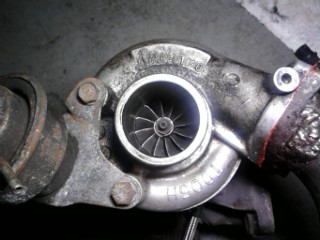

Popped off the turbo and this really doesnt look like a Evo3 B16g. Can someone look at this picture and tell me if they think it really is?

WTF is that growth on the outlet elbow?

Get a pic of the numbers on the comp. housing and we can tell u what it is, there is a thread on tuners about the numbers vs. big, small, E3 16g.
Welds.

As you can see this evo3 16g looks VERY different than what i have, main thing being the compressor wheel. the one i have looks like they put an exhaust wheel on the compressor side. WTF

looks more like a 14b dude. what's the serial number say? e316g compared with this is big difference. i'll see if i can compare my b16g with my e316g i have currently.

No. Im sorry, i was mistaken, i rechecked the for sale thread and it says Small 16g. Dammit. I really hate small 16gs.

No. this is what came with the car. I dont plan on changing it until the big boy goes on. BTW, the above picture was from google images. the very top picture is of my actual turbo.

yeah, at first i was looking at my turbo suspecting it was a 14b because of the serial number. Later jhann dude found out that it had the e316g compressor wheel with the 14b housing. Previous owner did that.

yeah both of those have a completly different compressor wheel then what i have.

Ok how similar do these look... http://media.photobucket.com/image/t...14BRebuild.jpg

^^yeah. i thought the big 16g had the double fins instead of the 14b fins?...both ways, i don't like the 'small' turbos but evo 3 is a pretty badass turbo.

the link is a 14b. the attached is my turbo. hmmm. maybe awd-drifter was right.

they look exactly alike. I think the last serial numbers are also the same. 1030

Nice 14b. Haha, oh boy.

I've posted the info and links on how to tell what the turbo is by the stamp of the last two digets on the comp cover on here like five times, hit the search button punk! Looks like a 14b to me.
Was it sold to you as a 16g?

any 16g will have the 6-bladed comp wheel, not the 10+ like in the pic above. Sorry man, I'd ask for some cash back on that deal, ouch...then again, at this point maybe just say eff it and keep moving on it.

Yeah, that turbo you have is a 14b.
