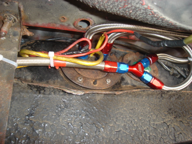

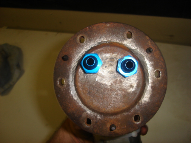

I used a Y. A T just didn't seam right to me and I didn't have enuf space inside the tank (FWD). I used two -6 bulkheads out of the sender a couple feet of fuel line and a Nos -6 Y.

I also ran a Y "NOS" brand fitting. I had around 8" of AN-6 from the tank bulkheads then it fed into the 1/2" line.
However with C-16, I was at the limit of my 880's for flow at the 50psi base pressure I had (even with a ported FPR), well atleast as well as my AEM could control them.
